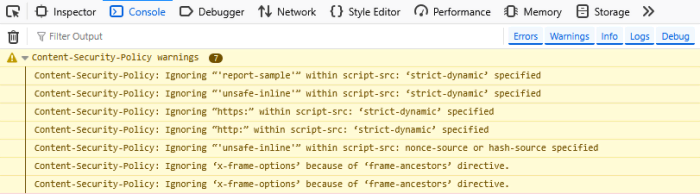

4. Check for network requests and console errors
Use your browser’s developer tools to check for script errors or blocked requests.
  • In Chrome, Edge, or Firefox, press F12 (Windows/Linux) or Command + Option + I (Mac). You can also right-click anywhere on the page and select Inspect or Inspect Element.
  • In the Console and Network tabs, look for blocked requests or JavaScript errors that may indicate where the integration is failing.
If requests to an external service fail, make sure the corresponding script or endpoint is reachable and not restricted by your site’s Content Security Policy (CSP) or by a consent management platform (CMP).

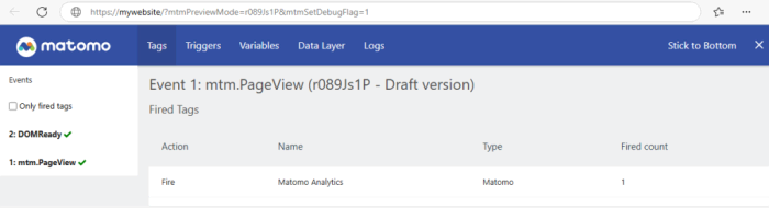

5. Verify the Matomo Tag Manager setup (if applicable)
If the integration is added through Matomo Tag Manager, use Preview / Debug mode to test how the tag behaves on your site. This lets you check that the tag fires at the right time, in the correct order, and that all required variables are populated as expected.
debug window in tag manager
Also ensure that tag, trigger, and variable configurations are correct and that any consent requirements are met before the tag fires to prevent blocking or missing data.

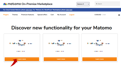

If the issue persists after completing the troubleshooting steps, contact the developer of the third-party plugin or integration. You can usually reach them by clicking the Learn More button on the plugin’s tile listed on the Matomo Marketplace page:
click learn more on plugin tile

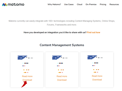

If the third-party tool is listed on the Matomo Integrations page, click the Download link to redirect to the provider’s website or GitHub repository:
click download integration
