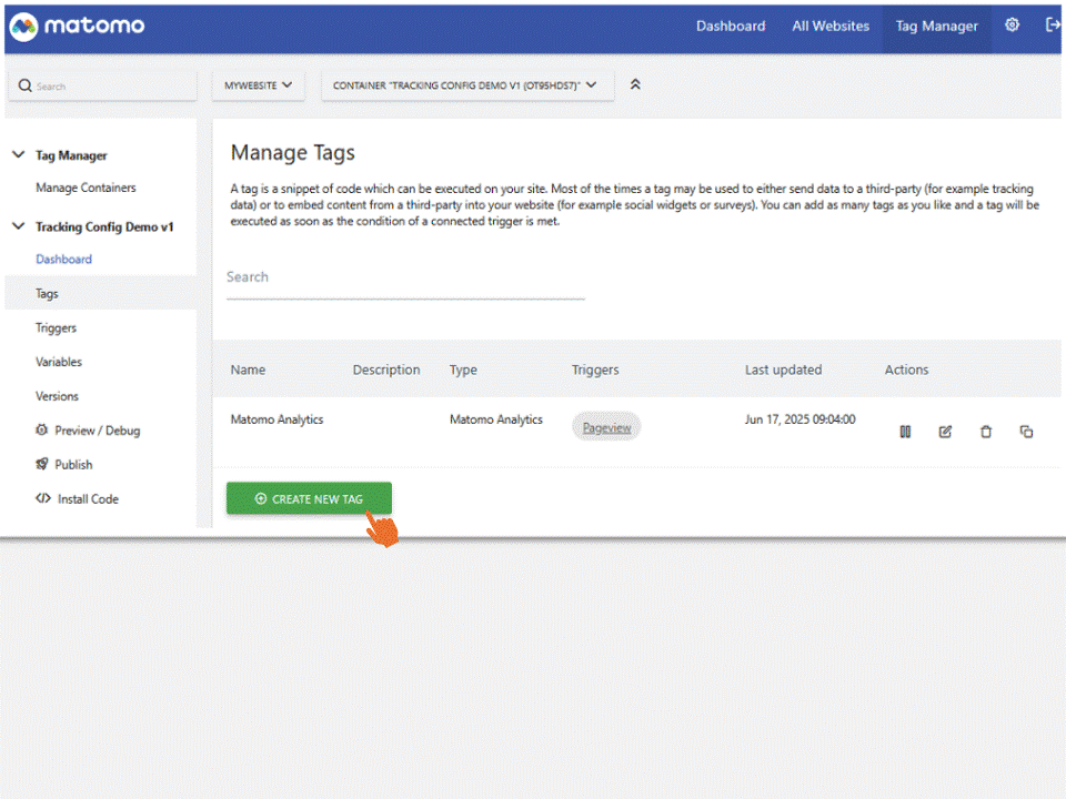

- In Tag Manager, navigate to Tags and click Create New Tag.
- Choose the OneTrust tag.
- Provide the Data domain script found in your OneTrust account > Scripts.
- In the section, Configure when the tag should do this, select a Pageview trigger.
- Click Create New Tag to save the OneTrust tag.
