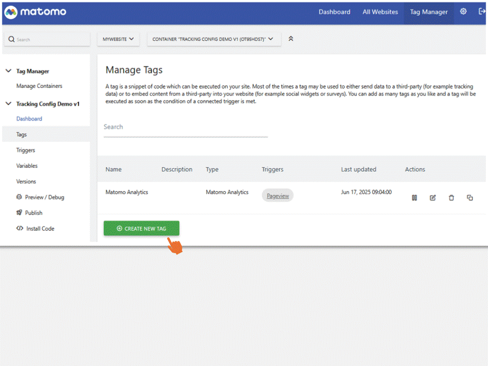

  1. In Tag Manager, navigate to Tags and click Create New Tag.
  2. Choose the Cookiebot tag.
  3. Enter your Cookiebot Domain Group ID (found in your Cookiebot admin account > Implementation).
  4. In the section, Configure when the tag should do this, select a Pageview trigger.
    configure cookiebot tag in matomo tag manager
  5. Click Create New Tag to save the Cookiebot tag.
