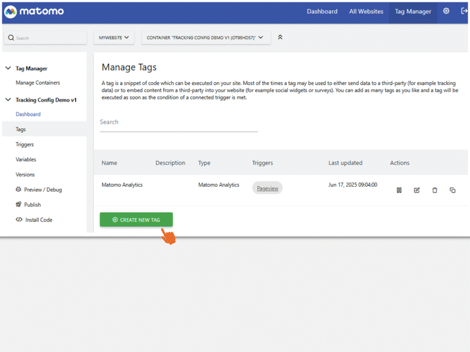

  1. In Tag Manager, navigate to Tags and click Create New Tag.
  2. Choose the Custom HTML tag and provide a custom name (optional).
  3. Paste the Osano initialisation script in the Custom HTML field. The CMP script can be found in Osano > Configuration > Get code.
  4. In the section, Configure when the tag should do this, select a Pageview trigger.
    add osano script to custom html tag
  5. Click Create New Tag to save the tag.
