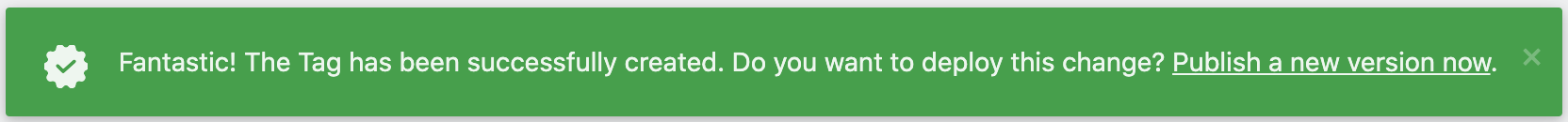

  11. Finally you will need to publish your container. You can do this from the success message that appears when you create a new tag or by selecting Publish in the menu.
    Matomo Tag Created Successfully

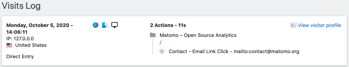

  12. Once your new event tracking tag is live, you should test that it is working. To do this, visit your site and click on an Email link. Then log in to Matomo, go to the Visitors section and click to view the Visits Log. This allows you to review visits in real-time and you should be able to see your visit with the event shown on the right-hand side.
    Event Tracking Visit Log
