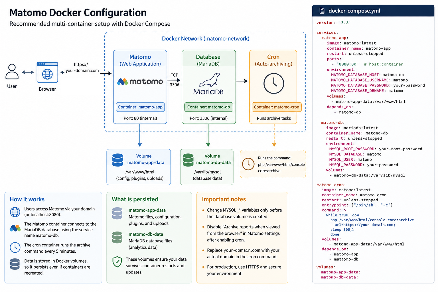

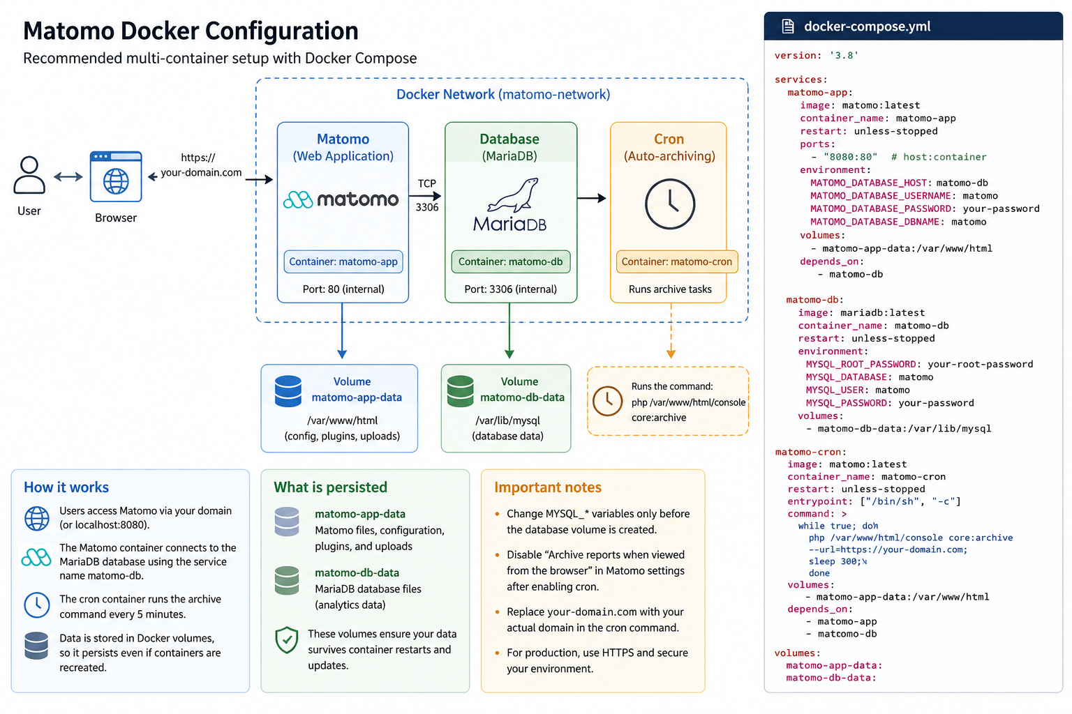

A multi-container setup runs Matomo and its required services as separate containers using Docker Compose. The example setup for this guide includes:
  • Matomo application container
  • MariaDB database container
  • Persistent volumes for Matomo files and database data
  • cron container for auto-archiving
Docker Compose creates the database container before Matomo connects to it. During the Matomo installation, Matomo connects to the database and creates the required tables.
matomo docker configuration

Run the following command for Docker to start the containers and create the Matomo database using the Docker Compose configuration file (docker-compose.yml).
docker compose up -d
Complete the Matomo installation by opening your Matomo URL in a browser and going through the setup wizard.
During the install, enter the database details as configured in the docker-compose.yml file. Matomo will then create the required tables in the database.
  • Database server: db
  • Username: matomo
  • Password: your configured password
  • Database name: matomo
Check the container status to ensure all containers are running.
docker ps -a
