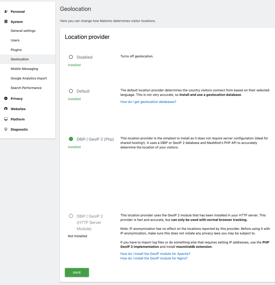

On arrival at the Geolocation page, you’ll find the following four configuration options:
Disabled – If you don’t need or want geolocation data for your users, this is the most private option and will completely disable Matomo’s geolocation features.
Default – The default option guesses a visitor’s country based on the language that their browser is set to use. This is not very accurate as languages can be used in multiple countries and people may default to their native tongue even when living overseas. This setting should probably only be used if you can’t use a geolocation database for some reason.
DBIP / GeoIP 2 (Php) – Since version 1.9, Matomo has included the ability to check a visitor’s IP address against a database of known and estimated IP locations to more accurately determine the location of your visitors. The PHP API method is the simplest way to do this and is typically the best option if you use shared hosting as it does not require any additional custom server configurations which may not be in some shared environments.
DBIP / GeoIP 2 (HTTP Server Module) – This is a more advanced version of the former setting which takes advantage of a GeoIP module installed on your HTTP server. This is a fast and accurate method, but can only be used with normal browser tracking and may require you to set up the GeoIP module if it isn’t already active on your server. Details on how to do this can be found at the following links:

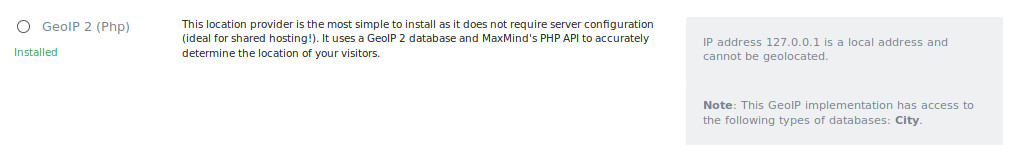

Once a GeoIP2 option is installed, it should be selectable and be Installed.

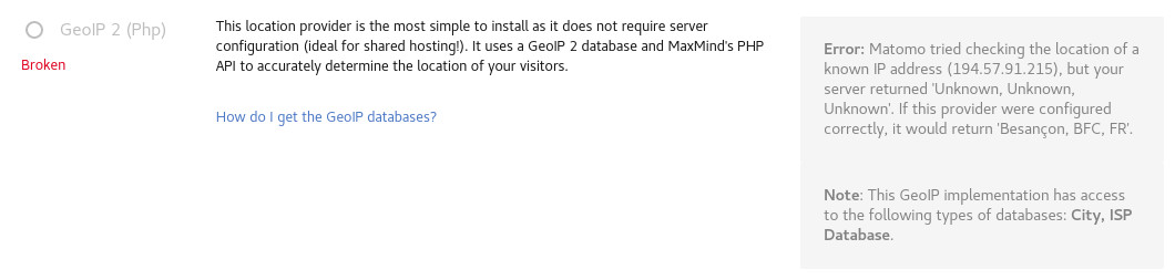

If there’s something wrong with the setup, it will be Broken, and the reason why will be displayed.

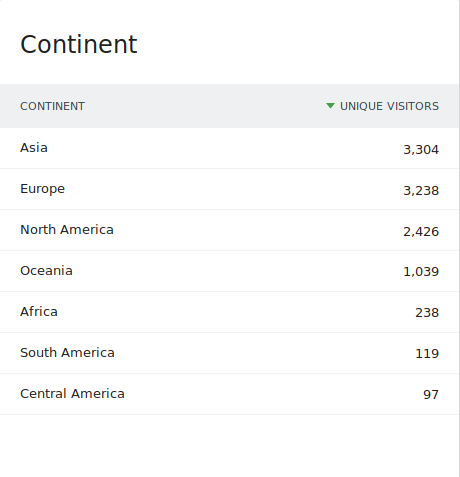

Reports: Continent, Country, Region, City & Provider
The geolocation feature provides the data for all of the reports on the Visitors > Locations & Provider page. On this page you can see what geographic locations most of your visits come from.

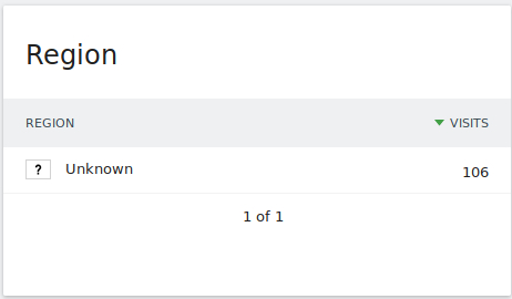

The Region & City reports will only be populated if a GeoIP2 geolocation option was used when tracking the visits during the period. Otherwise, they will have one “Unknown” row:
