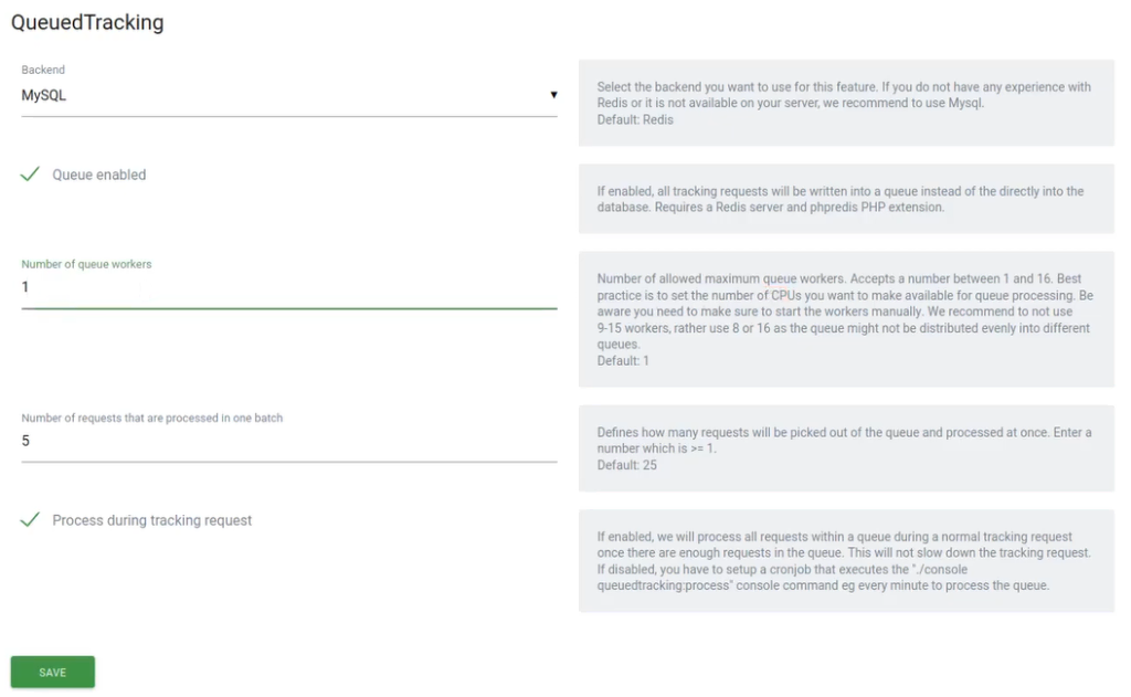

  5. In the plugin settings, you can configure:
    • Number of queue workers: Defines how many parallel processes handle queued requests (higher values handle more traffic but use more CPU).
    • Batch size: Defines how many requests are processed at a time before being sent to Matomo.
For many sites, the default settings work well and are a good starting point, but everyone’s environment will have different optimal configurations.
configure QueuedTracking plugin
Note the following exceptions:
This field accepts a number between 1 and 16. Best practice is to set the number of CPUs you want to make available for queue processing. Be aware you need to make sure to start the workers manually. It is recommended not to use 9-15 workers, instead use 8 or 16.
We can share that one customer who successfully queued up to 10,000 requests per second during traffic spikes had their configuration set for queue workers: 16 and number of requests to process: 25.
Process during Tracking Request
The last option is checked by default: Process during tracking request.
When you have multiple servers, it is recommended to disable this option and instead use a Cron (or in Windows, a Scheduled Task) to activate queue workers. The recommended method for this is to start a queue worker once every minute:
* * * * * php /path/to/matomo/console queuedtracking:process --no-ansi >/dev/null 2>&1
This should ensure that enough queue workers process the queue. You would execute this on each host that you want working on the queue (i.e. tracking servers). It’s fine to start this command from multiple different servers all working off the same database, as each queue worker will lock the table, take out the set number of requests, and then unlock the table for other queue workers to continue.
