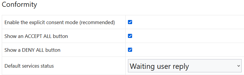

- If using Method 1 or 3 (described below), ensure the Tarte au citron Conformity settings are configured. Click the three vertical dot menu and select Options > Conformity settings:
- Enable the explicit consent mode (recommended).
- Default services status: set to Waiting user reply.
- The Conformity settings may differ if implementing Method 2 (described below).

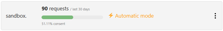

Once your account is set up, you can run Tarte au citron in Automatic or Manual mode.
- Automatic mode detects the Matomo tracking code and consent handling script on your site with minimal configuration in the CMP.
- Manual mode requires more steps to manually configure the consent manager:
