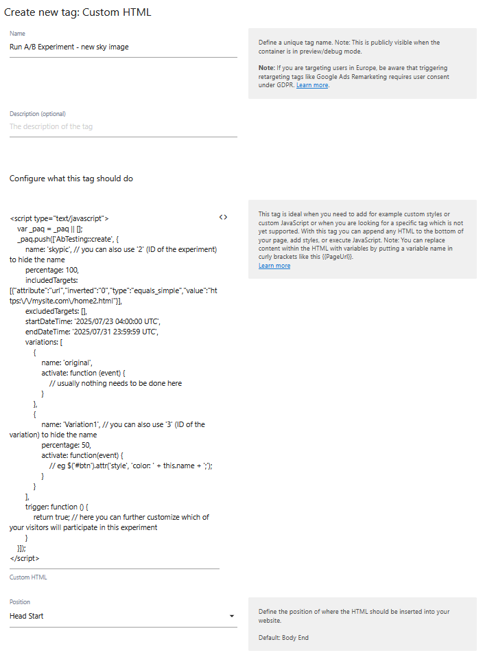

- Go to Matomo > Tag Manager and open the container to edit.
- Choose Custom HTML as the tag type.
- Paste the experiment code snippet into the Custom HTML field.
- Set the Position to Head Start, so the script is injected first in the
<head>
tag.
- In the section, Configure when the tag should do this, assign a Pageview trigger to run the experiment when the page loads. If you use a DOM Ready or Window Loaded trigger, a fire delay should be defined on the Matomo tracking tag.
- Click on Advanced settings to set the tag’s Priority to a low number such as
1
. The default is999
, so using1
ensures your experiment runs before other tags. Matomo Tag Manager uses priority values to decide the order of execution. Lower numbers run first. - Make sure no other tags (like your Matomo tracker or page modification scripts) run before this experiment tag.

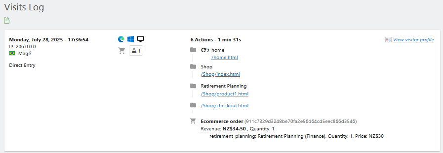

- Check the Matomo Visit Log report to verify your test entry on the experiment page was correctly recorded.
