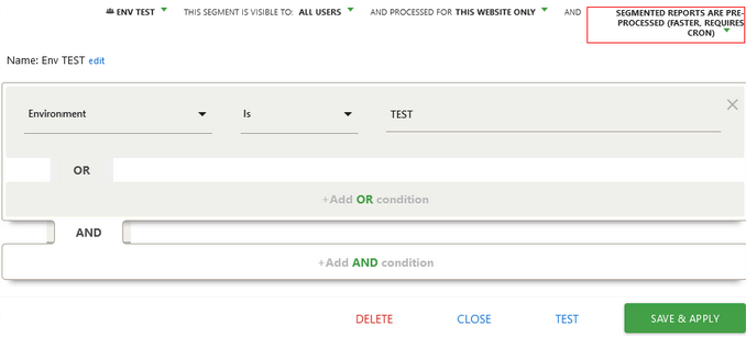

  1. In the Matomo Dashboard, expand on the Segment Selector.
  2. Click Add new segment and create the segment you are using in your API call.
  3. In the segment editor, choose the configuration option, Segmented reports are pre-processed (faster, requires cron).
    matomo segment editor
  4. Ensure your cron job is running regularly (e.g., hourly), so the segment data is processed during archiving.
  5. Update your API request to use the saved segment.
